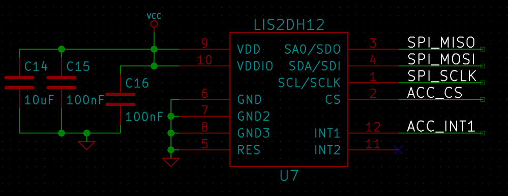

What bus are you using, I2C or SPI?
Are there any other devices connected to this bus?
Can you share you schematics and layout?

We're using SPI (MOSI/MISO/SCK/CS).
VCC is 2.8V
There is another device on the bus that is driven with another CS line.
Of course, we designed the code so they never ever talk together at the same time.
Also, values close to zero were also observed during some ''weird-phase-time'' of the sensor.
Last but not least, I may have some information about the issue. I'm not sure but the issue might trigger sometimes when I re-flash my MCU.
As the whole board power stays on the whole process, maybe in certain cases when the MCU is speaking with the LIS2DH12 and get interrupted (due to reset/flash process), the LIS2DH12 enters this weird state.

After some tests, it seems that when I stop all comunications with the other SPI device (same bus), the LIS2DH12 stops enterring this weird state.
Perhaps there is something like data transmitted to the other device interpreted as I2C frames (CS = 1: SPI idle mode / I2C communication enabled). On top of that the SPI communication speed is way faster than the I2C max speed (4MHz).
Is it possible to somehow disable the I2C interface ?
