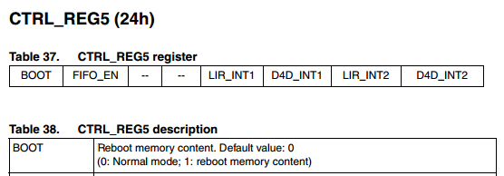

I would recommend you reboot memory content by writing ''1'' in BOOT bit in CTRL_REG5 after power up sequence.
