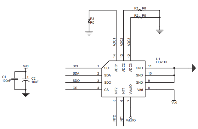

Please note that once the LIS2DH device is powered up, it automatically downloads the calibration coefficients from the embedded flash to the internal registers. When the boot procedure is completed, i.e. after approximately 5 milliseconds, the device automatically enters power-down mode. So if there is some over-current consumption after this procedure and before the first SPI of I2C communication with the sensor, there could be some issue in the hardware connection / schematic. Can you please share it or check if it is coherent for example with the STEVAL-MKI135V1 one? Vdd and VddIO can be tied together.

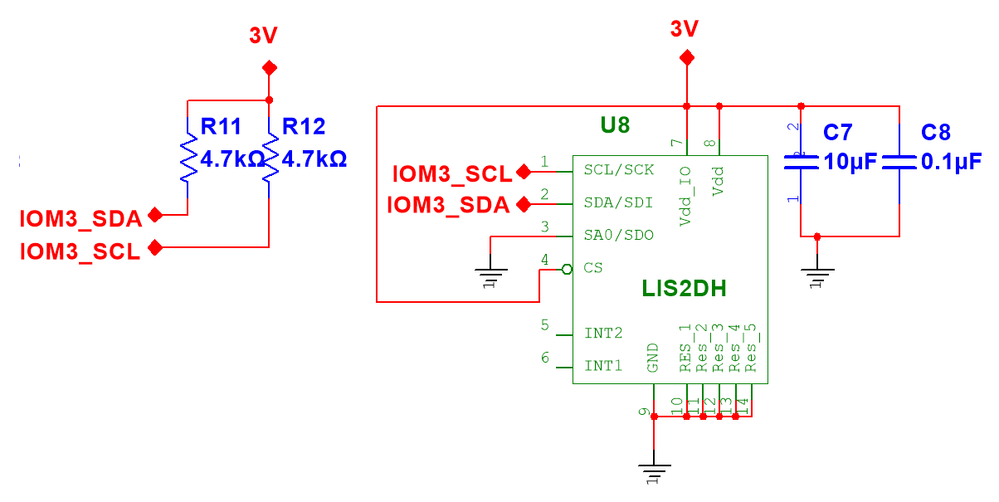

However, without configuring - on a power cycle - it still consumes 150 uA.
This is my schematic and I made connections just as in reference design.
We got boards made from 2 manufacturers and all boards test like this. Please advise.

Hi @PK.1​ ,
the hw connections looks ok... can you try to separate Vdd and VddIO and try to power them separately?

Hi @PK.1​ ,
I checked and the SDA and SCL lines on the LIS2DH ASIC should be internally connected to positive supply voltage via (weak) pull-up resistors. So, if you force them to GND through application processor, you could experience an over-current consumption (150uA is somehow high and the pull-up path consumption should in case be dominated by your 4.7kOhm resistors, but can try to leave these pin floating at AP side).
