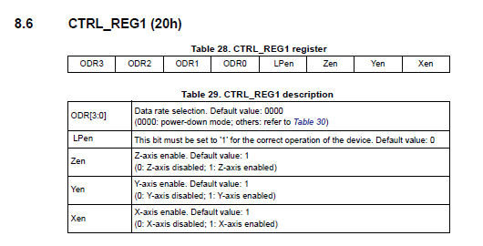

According to the datasheet the ''LPEN'' must be set to 1.
You should write 0x5F in the REG1, as I understand it.
I hope it will help you, but as it's not working for me I doubt.
Denis

Thank you for pointing that out.  I gave it a try, but unfortunately it did not make a difference.  Please post back if you get it working and I will do the same.
Posted on October 12, 2017 at 17:02
I've got it working!  Using the settings below, when I read the INT1_SRC register I can see the bits changing as I move it around, and if I either leave my processor interrupt pin floating or pull it low, I will get an interrupt from the LIS2DE12 on the INT1 pin when motion occurs.  Reading the INT1_SRC register clears the interrupt until motion occurs again.  I hope this helps!
