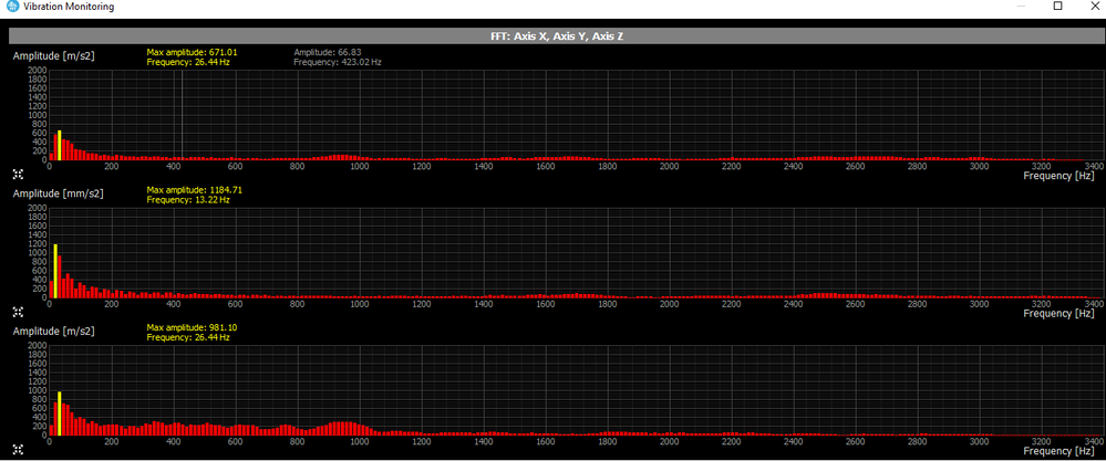

We have designed custom board which has STM32F446RE MCU and ISM330DLC vibration sensor.
We are able to send FFT data with 512 sample to Unicleo-GUI and able to observe the FFT data for X,Y,Z axis on graph.

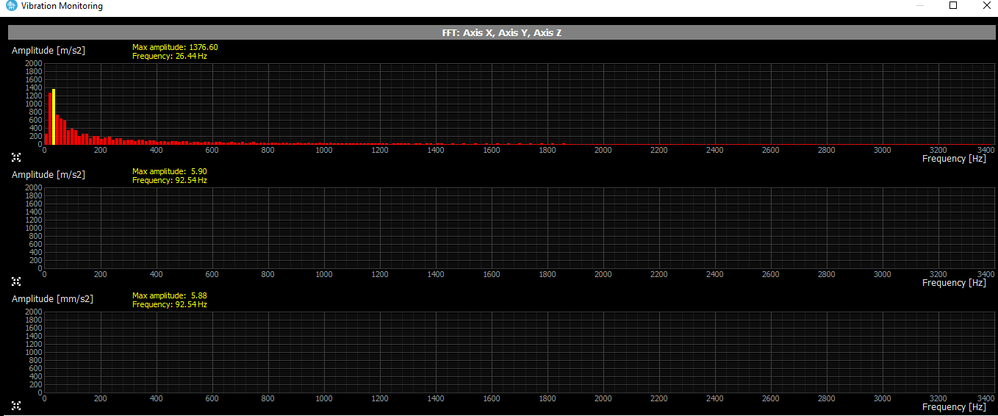

0693W000006F3FDQA0.pngBut when we send FFT data with 1024 samples to Unicleo-GUI, FFT graph for only Z-axis is visible.0693W000006F3GBQA0.pngPlease let us know what is the limiting factor in Unicleo-GUI to represent [1024] more samples.

To fix the limitation of FIFO size we have used software FIFO to store 1024 samples.
We have sent the FFT data to Unicleo-GUI.
But the FFT data for 1024 samples is not represented in Unicleo-GUI.
Regards,
Rajesh K.
Hi Rajesh,
so this is a limitation of Unicleo-GUI. I'll consider it in the sense of a "bug report", and report it internally.

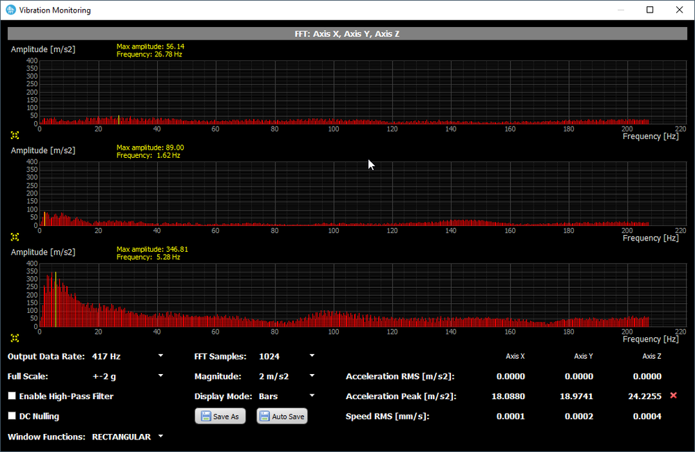

Unicleo-GUI is able to display FFT with 1024 without problems. But a few changes must be done in FW.
MotionSP_Config.h:
#define FFT_SIZE_MAX         FFT_SIZE_1024
sensor_def.c:
static const uint32_t Lsm6dsoSamplesList[] = {3, 256, 512, 1024};
This change will enable to setup the number of FFT samples to 1024.
I used standard example for vibration monitoring for demonstration. But customer will have to change settings for ISM330DLC sensor.
In main.c file inside function “Collect_Data�? must be removed checking for “samples_in_fifo�? on line 659 (FIFO is not able to handle 1024 samples for three axes) and checking for timeout on line 667. In other case the program will end up inside error handler function.
0693W000006FzJrQAK.png0693W000006FzJSQA0.pngAnd finally the project must be build with code optimization for size in order to fit all data structures into SRAM. MotionSP library is consuming a lot of memory, 1024 samples is maximum value.
