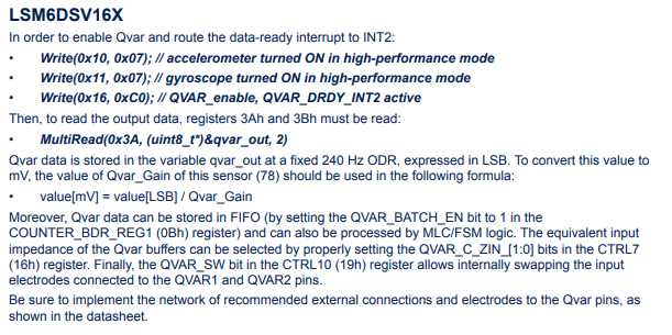

There isn't a library only for Qvar sensor but you can refer to the Application Note AN5755.
In section 4.2, there is the register configuration for LSM6DSV16X to enable the Qvar sensor and how to read the results.
