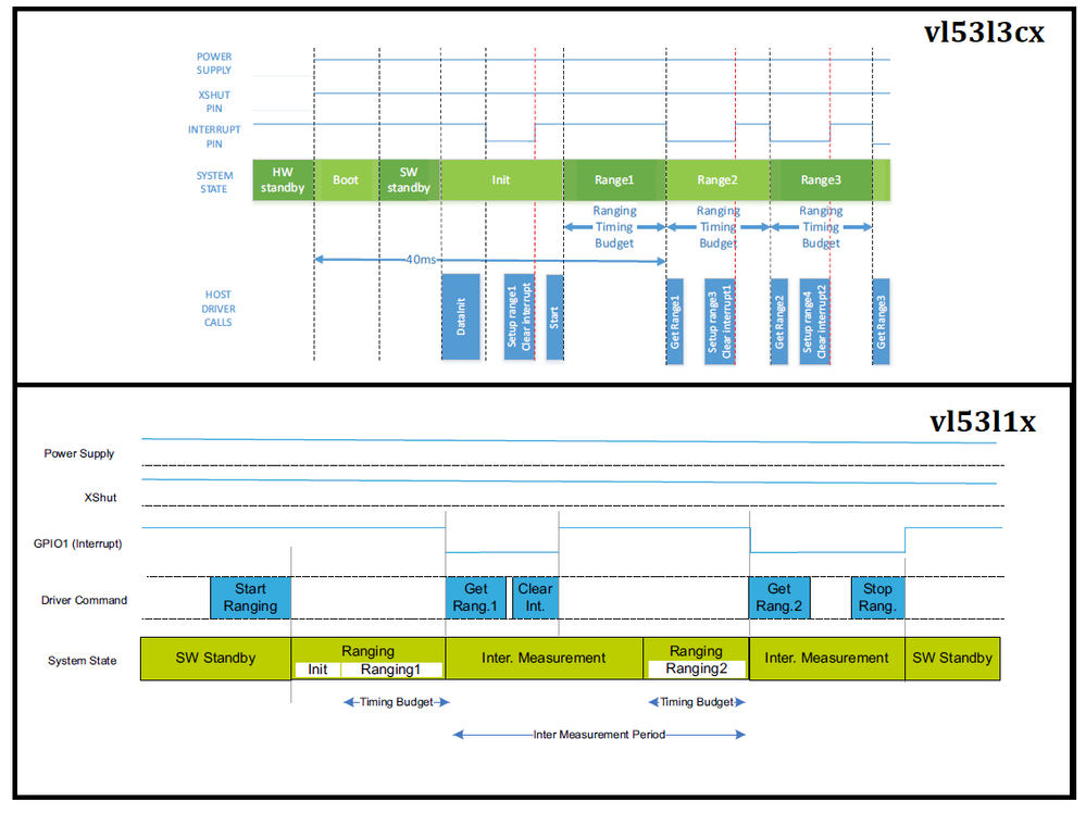

My doubt is related to the fact that the way of managing the timing of the two ToF types seems different. I hope I can explain my problem well. I have tried two strategies to manage different VL53L3CX ToF (let's consider the case of 6 ToF).

Both of these strategies seem to work well for small timing budgets (8-30 ms), but when setting high timing budgets the ToFs don't work well. I believe this means that I am mishandling the 6 ToFs.
I could not verify if this also happens for the ToF VL53L1X, but comparing the two User Manuals I realized that while the VL53L3CX provide the information of the i-th measurement while the measurement (i + 1) is carried out, in the case of the VL53L1X the information of the i-th measurement is obtained during the inter-measured.period preceding the measurement (i + 1).
Considering all this, I would like to know if the performance problem, in the case of 6 ToF, is related to different aspects of timing compared to the VL53L1X or if I did not write the code well and I did not respect the ranging flow for the VL53L3CX.

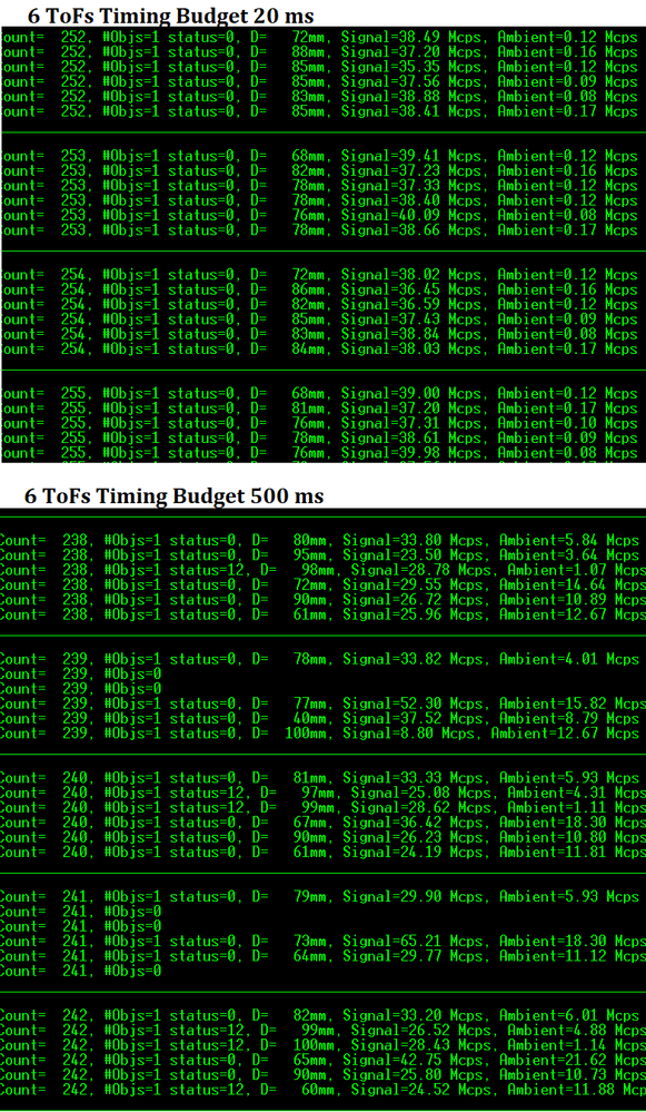

Thanks Julien.
I am using a NUCLEO-F401RE to control 6 ToF VL53L3CX.
Previously I used only one ToF, and for any Timing Budget selected, the ToF recognized the presence of an object (even 2 objects) and gave me the exact distance.
Then I decided to make several ToF work sequentially(like the demo MultiRangingSensor for VL53L1X), up to 6 ToF. I noticed that by working with 6 ToF, setting high TB, 2 or 3 sensors could not detect objects, and often the detected objects were accompanied by range status different from zero. The curious thing is that always using 6 sensors, but setting low TB (about 20 ms) then those problems that I listed before do not arise, In fact, All 6 ToFs detected the presence of objects with range status = 0.
I hope what I wrote is understandable.
Vincenzo
I have captured two images of my desktop while TeraTerm shows the ranging information. In the first case there are 6 ToF with Timing Budget = 20 ms, in the second case always 6 ToF with Timing Budget = 500 ms. The initial conditions, excluding TB, are practically the same. 6 sensors placed in line and an object placed at a distance of about 7-10 cm from the 6 sensors. What I don't understand is why in the first case the measurement is clean, with no "holes", while in the second case there are "holes" and some range status different from zero (often status = 12 which should means that there is a target but the signal is too low)
I hope that this will make it clearer
