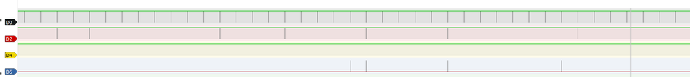

I have been trying to test and get the gyroscope to communicate via SPI for a bit however it just seems to *refuse* to respond. As per the User manual for the board UM1670, PC1 is CS, PF7 is the serial clock, PF8 is MISO, and PF9 is MOSI all for SPI5. I suspect something is wrong with my setup of pins but I cant find what, so far I have:
Enabled the SPI5 clock as well as Port C and Port F clocks.
Configured PF7-9 as AF5, no pull.
Configured PC1 as general purpose output with no pull, and then set it to high in ODR (Since CS is high by default). Then I initiate SPI5 and begin by trying to send 2 bytes of data, 0x20 and then 0xf to the Gyro's CTRL1 register. After that as a test I keep trying to get info from the WHO AM I register just to test communication.
The only thing I get on the SPI bus is the value '255', which I assume is just all 1s. I used a logic analyzer to see what was happening and saw no activity on the MISO line.
I can't seem to understand if theres something I am missing with initializing communication with the gyroscope, or am I missing something with initializing the SPI. Here are the relevant code sections:

something else I just noticed while looking at the logic analyzer, is other than the fact that MISO (D4) does not even move (likely the reason why I only get 0xFF returned back to the master) the clock movement (D2) seems a bit not only erratic when it goes down, but duty cycle seems very very slow, though I am using the default STCUBEMX SPI initiation settings.
