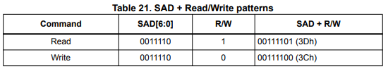

Hi, the fact you are reading 00h on the WHO_AM_I make me suspect the issue is on the communication. Could you check the integrity of the I2C transmission and share the oscilloscope or pattern analyzer screen? Which frequency / Vdd or VddIO / pull-up value are you working at? To check the issue is related to the communication and not to the sensor, you could try interface to it to through the SPI. I think you already did it, but please note that the 8bit I2C slave address is 3D or 3C and not 1E.
