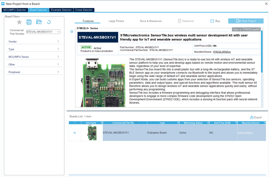

Hi @ShivaRagu ,
I'm not sure to have understood your point...
Once you have uploaded the .bin file via USB in DFU mode, you need no more further uploads (just unplug and plug the battery, in case of issues). Then plug again the USB cable and you should see the battery charging with the red led blinking.
The STEVAL-MKSBOX1V1 hardware configuration is available on STM32CubeMX in the example board section, as you can see from the picture below:
If you need to merge the CubeMX with the schematic of the SensorTile.box for your project, I suggest you to check it HERE.
-Eleon
