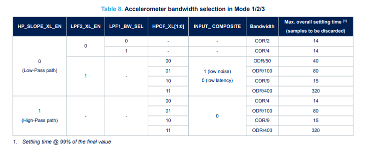

Hi, the maximum bandwidth is equal to ODR/2 (if no filter is applied on the acquisition chain), as for Nyquist theorem.
You can fin the description of accelerometer max bandwidth (i.e. maximum detectable frequency) at p. 13/14 of the AN5125

We will check if we can validate the data by using ODR/2 as sampling frequency.(If no filter used) and respond here.
