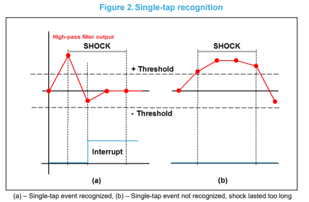

Hi @Community member ,
even if the LIS2HH12 doesn't directly implement the tap detection, you can consider the DT0101 design tip, that suggest you how to implement this feature on accelerometer even in the absence of the direct digital feature, for example the LIS2DH12.
For single-tap recognition there are two parameters to set up – threshold and shock time window.
In the LIS2HH12 case, you can tune ACT_THS (1Eh) and ACT_DUR (1Fh) to define the shape of the single tap event, as shown in the picture below:

Hello Eleon,
Thanks for the answer. I have set ACT_THS=0x30 and ACT_DUR=0X18. along with the single tap if I move the device it detects as tap. I am still not able to detect only the double-tap.

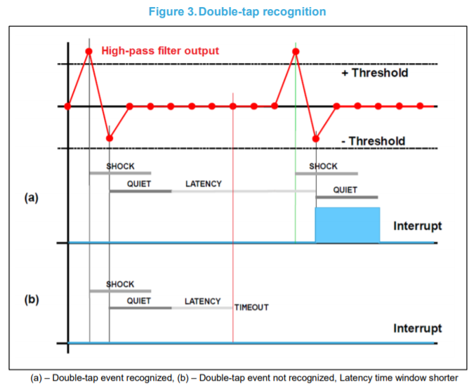

I'm afraid that on LIS2HH12 the double-click cannot be implemented, since for this feature recognition you need to set up four parameters, so you would need additional registers that are available on LIS2DH12 or LIS2DW12. In fact, besides the threshold and shock time window which are the same as for single-tap recognition, there are also the quiet time window and latency time window parameters.
But you might implement the feature at software level: when you detect a single tap, you start counting the subsequent data (the timing is determined by the ODR), and if you detect another tap within a certain interval you can interpret the overall event as "double tap". This would simulate the quiet time and the latency windows.
Let me please know if this software solution is feasible for you.

2021-06-23 4:19 AM
Thanks, Eleon for the reply.
Getting the exact time interval between 2 taps is a bit tricky. Even if I set a time interval, moving the accelerometer without tapping also detects the interrupt.
Thanks
