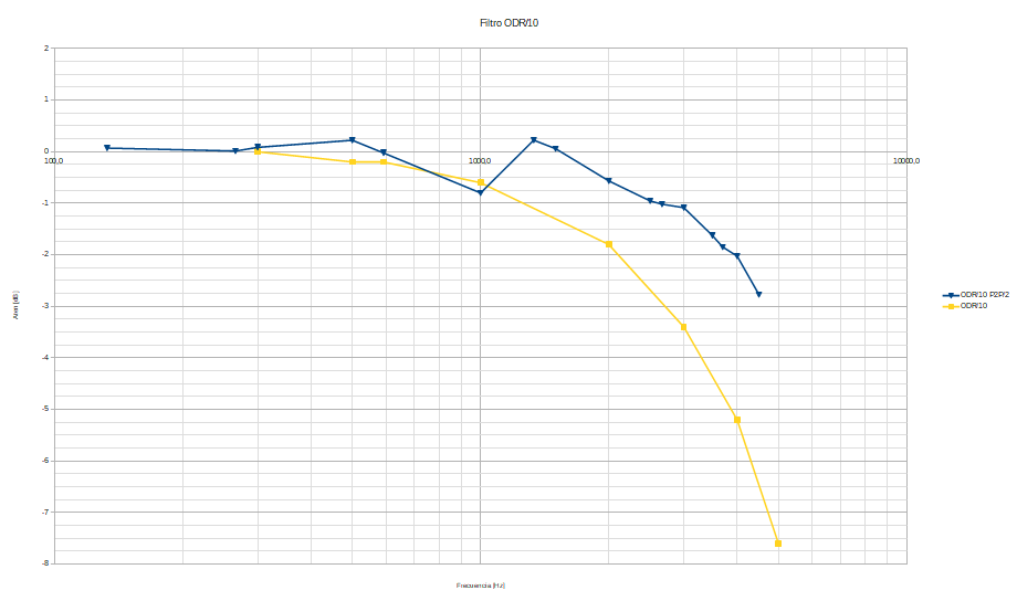

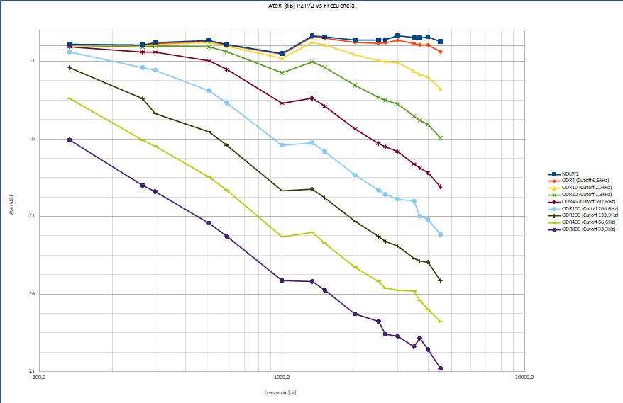

We have been using the IIS3DWBTR sensor for some time and have observed some odd behavior regarding filters. We recently performed some experimental tests on the LPF2 Filter to corroborate the frequency response curves on page 20 of the datasheet and found that it didn’t behave as intended. Oddly, we found that (experimental artifacts aside) the experimental curve had a better match with the *next* filter cutoff configuration. For example, the experimental results when configuring LPF2 with a cutoff frequency of ODR/20 has a good match with the theoretical curve for a cutoff of ODR/10, as shown in the next plots (yellow is theoretical, blue is experimental).

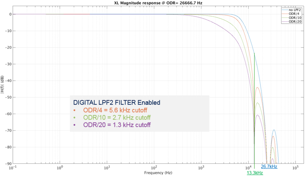

Theoretical response on page 20:
0693W00000KZwDXQA1.pngExperimental Response for us:

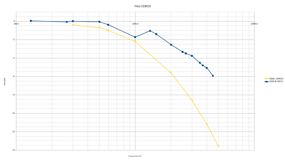

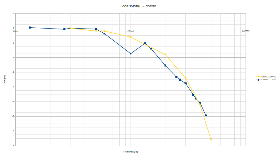

0693W00000KZwDDQA1.pngODR/10 Theoretical vs ODR/10 Configured:0693W00000KZwEaQAL.pngODR/10 Theoretical vs ODR/20 Configured:
0693W00000KZwFEQA1.pngODR/20 Theoretical vs ODR/20 Configured:

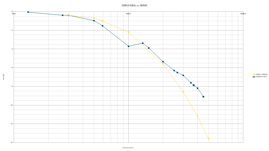

0693W00000KZwPYQA1.pngODR/20 Theoretical vs ODR/45 Configured:
0693W00000KZwQ2QAL.pngOn our tests we used the following configuration:

The experimental tests were back-to-back tests against a reference piezoelectric accelerometer mounted on an electrodynamic shaker. The signal measured from the piezoelectric was used as reference to calculate the attenuation.
We would appreciate your comments regarding LPF2 performance from your experience or possible explanation for this behavior. Maybe we are not configuring it right. Any suggestion is welcome.
