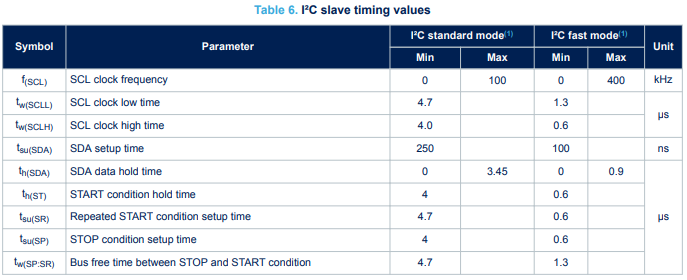

>> Are there any I2C communication timings available available.
The digital block of the I2C for the IIS3DWB is similar to other ST devices, especially the IIS2ICLX.
>> Can I restrict FIFO content to Tag and three Z axis readings
>> Is there a method to burst read out of the FIFO?
I'm afraid that the FIFO usage is the one that you depicted, i.e. you have to deal with the 7 bytes and the FIFO_DATA_OUT 3-axis pattern. I'm however not able to try your configuration right now, but if you can try them it can be useful.
