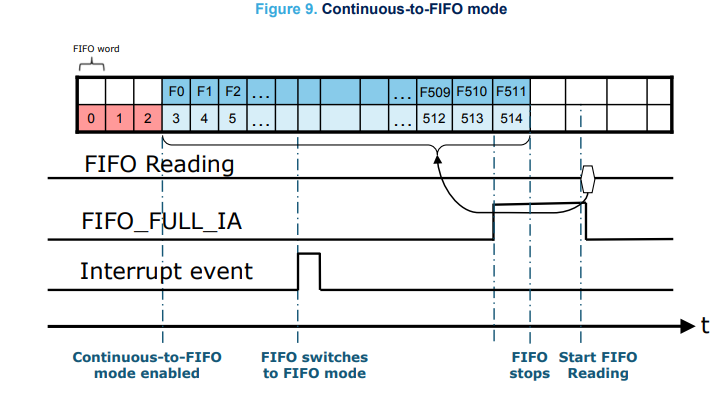

I see you are configuring the "Continuous Mode", which is however not so suggested for working with interrupts.
You should use Continuous-to-FIFO mode for managing the FIFO interrupt.
Please have a look to the AN5444 application note, from p. 32.
-Eleon
