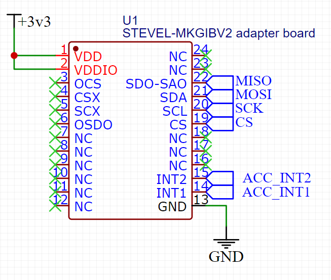

If the current consumption is constant, we should probably focus on the hardware: can you please share the schematic of your board? Is it in line with the STEVAL-MKI208V1K one?
-Eleon

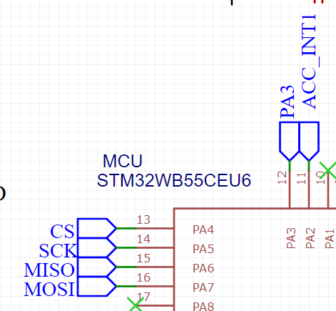

I'm using the STM32WB55CE MCU running a BLE application which controls the IIS3 though SPI1. While developing I'm using the STEVAL-MKI208V1K kit.
The application is using FreeRTOS tickless idle in STOP2-mode (I know from the MCU manual & ST presentation that the SPI is affected by this, but control haven't been an issue yet.
Relevant part of schematic:

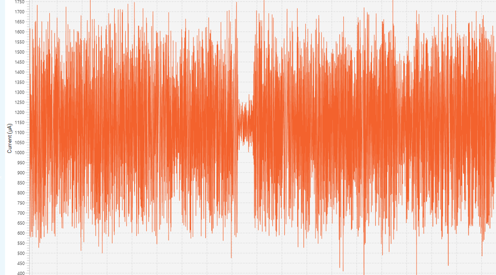

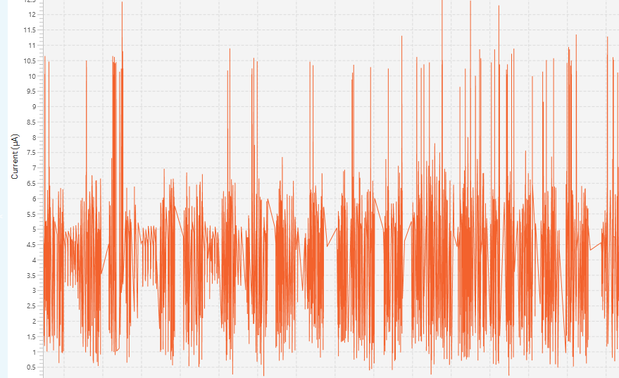

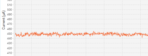

I've made a few measurements using the X-Nucleo-LPM01A board:
Consumption of board without the IIS3:
0693W00000NshJBQAZ.pngConsumption of board + IIS3-kit - IIS3 in full power mode:

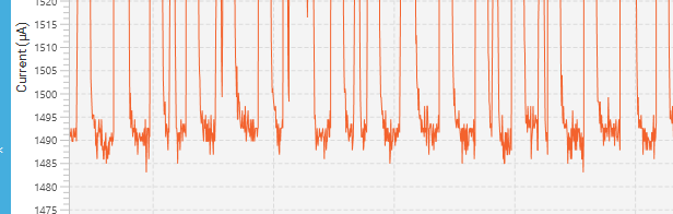

0693W00000NshKTQAZ.pngConsumption of board + IIS3-kit - IIS3 in low power mode:

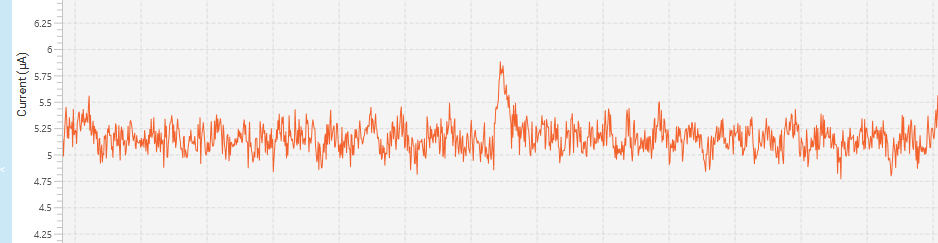

0693W00000NshKJQAZ.pngConsumption of IIS3-kit alone - IIS3 in full power mode:
0693W00000NshLlQAJ.pngConsumption of IIS3-kit alone - IIS3 in low power mode:
The Ampere increase when turning on the IIS3 fits the datasheet very well, but I'm confused what is drawing ~440uA in the 3rd graph...
My best guess is something SPI related, but not sure what...
Any ideas or hints?
