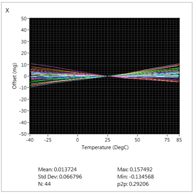

2020-03-31 3:18 AM
Hi John, I try to answer to your question here below.
You can find a plot of the X axis here below, from characterization data. Similar plot for the other two axis. the drift is inside +-0.2mg/°C
