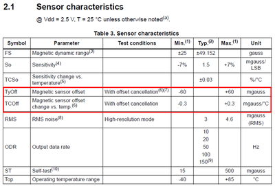

We are conducting research using 9 IIS2MDC sensors to detect the position of a magnetic material (e.g., N52 grade neodymium magnet). Since we expect the distance between the magnetic material and the sensors to be large, the sensors need to accurately detect the magnitude and direction of the magnetic field generated by the material. However, we have identified that the IIS2MDC sensors we are using have an error margin of approximately ±1300 mG, and we are encountering the following issues:
1. The offset indicated in the datasheet is approximately ±60 mG. However, even after completely removing the influence of the magnetic material, the initial magnetic field values measured by each sensor still range from 0 to 1000 mG. Since these initial values vary between sensors, we predict that this is not due to the Earth's magnetic field. We are curious about the possible cause of this.
