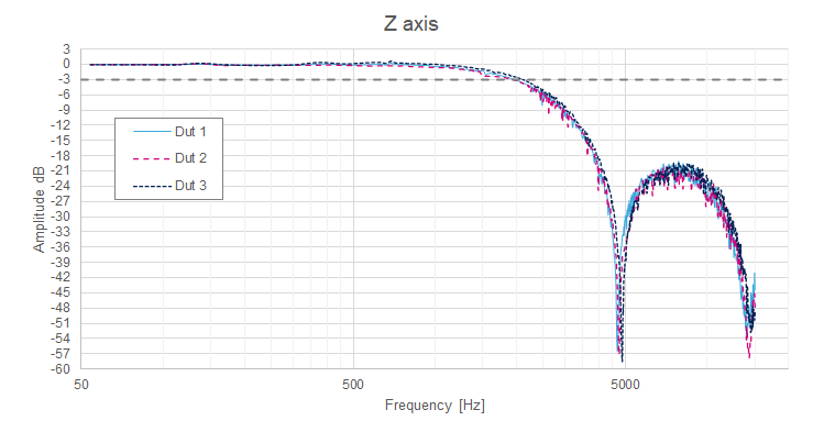

Hi @THart.14 ,
A little aliasing effect will probably occur, but the folded signal should be very attenuated.
This is for example the frequency response of the Z axis, that shows that the signal is very attenuated above 2kHz (which is half of the maximum ODR setting, Low-power mode (5.376 kHz)).
-Eleon

Hi @THart.14 ,
-Eleon

Thx, for your response.
But at lower ODR settings the chip will use lower ADC sampling rates eg at ODR=200Hz or 400Hz, thus this will lead to aliasing effects?

Please could you clarify that in the case not properly low pass filtered input acceleration data the only way to avoid aliasing is to set ODR to 5376Hz?

Hi @THart.14 ,
for lower than maximum ODR there is a low risk of aliasing folding, but the signal will be very attenuated.
