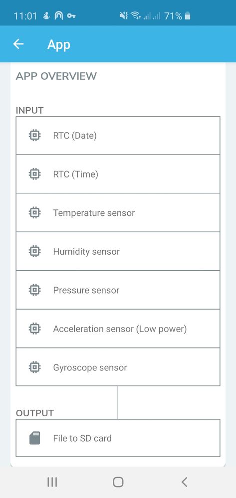

Hi @MMarq.1​ , which kind of datalog structure would you like to save? Please note that you can create your own app in "Expert" mode, selecting the sensors in the order you want and save it on the SD card (except from the microphone which will be saved in .wav extension, 16bit 16kHz pcm). Here below the Expert mode configuration:

I'm already successfully using the Expert Mode as you showed. I was able to save the output data with 'File to SD Card' and save DataLog while on "Stream to Bluetooth':
The latter data format is quite what I want, but I need to save raw-data from multiple sensors simultaneously. Also, the app limits the ODR when streaming to Bluetooth and I need higher values.
