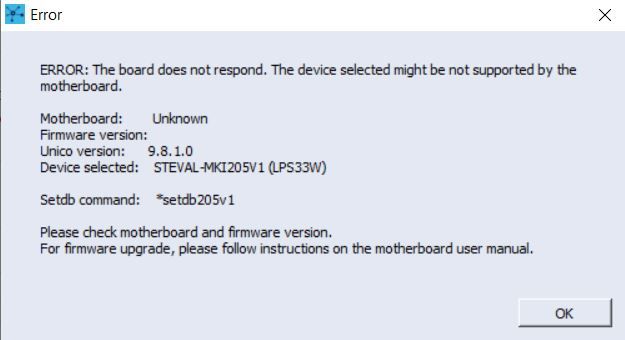

I have the STEVAL-MKI109V3 running with Unico 9.8.1.0, the board evualting is LPS33W (MKI205V1). It was working perfectly and now it gives me the error: The device selected might not be supported by the board

0693W000001tChHQAU.jpgI have been using it already for a couple of weeks, today I plugged it in and I get that error. I tried to flash it again with the .bin file provided to update the firmware, but of course it's the same as previous version. I also checked the port number, set it to manually identify it, but still get the same error. Can you please help me? thanks!

Hi @MFria.1​ , this sounds strange... sorry for the dummy question, but is the MKI205V1 adapter mounted in the correct way? Regards
thanks for the quick response. The adapter was mounted correctly, I tested with another board and had the same issue, in the end was the cable, physically looks fine, maybe internally it's damaged. I changed it and I got no issues anymore. Thanks for the support!
An hardware issue as well :face_with_tears_of_joy: Regards
