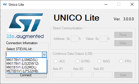

I have bpought a STEVAL-MKI109V3 + STEVAL-MKI105V1, but in UNICO Lite Rev. 3.0.0.0. I cannot find a selection for this kit, probably firmware of the board has to be updated. Cube Programmer is already installed, but where can I find the firmware image?

Ciao @stst9185​ ,
Unico Lite is graphical user interface software package, providing C# source code only for limited boards.
For the support of all the evaluation board for STEVAL-MKI109V3 (including STEVAL-MKI105V1), we suggest using the Unico-GUI software package instead.
After downloading the software package, you can find the firmware image in the “FIRMWARE/ProfiMEMSTool board�? folder.

stst9185
Associate III
Great, now I can select the right module!
It is a bit confusint, that there is a Unico software and a Unico-GUI software and they have different scopes of supported products.
Thanks!
