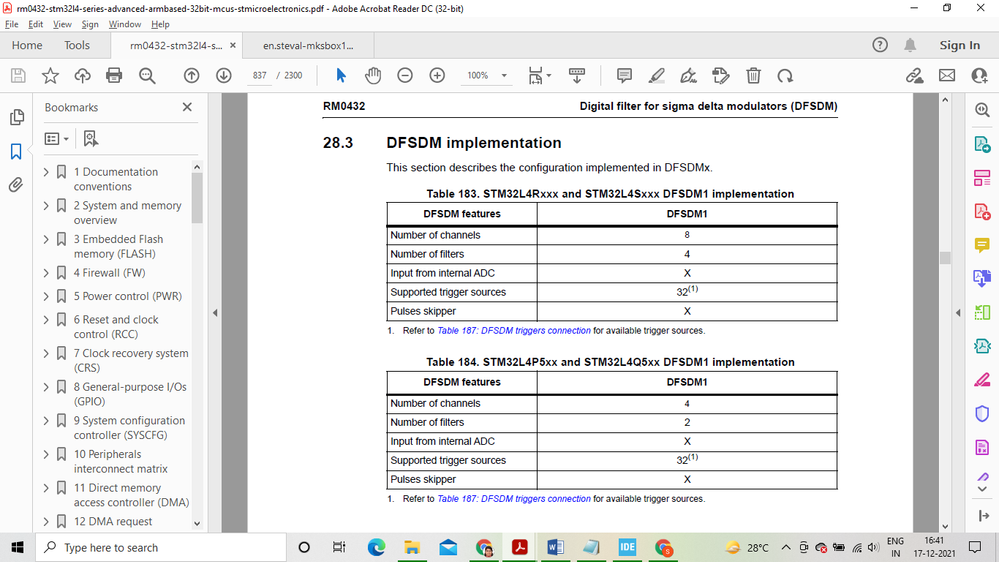

Yes, you can feed data from the internal ADC into DFSDM and process it there, see Digital filter for Sigma-Delta Modulators (DFSDM).

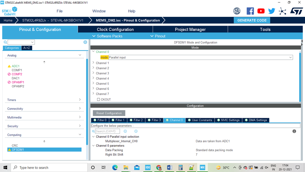

@Peter BENSCH​ Thanks for sharing the information. IS there is any document or application note to set DFSDM parameters in MX Cube like Filter 0 or Filter 1 , DMA setting and Channel Selection and the mode like -> pareller or manchester so on

You will find loads of information also in RM0432, e.g. section 21.4.27 and especially section 28.
Unfortunately, ST cannot offer a tutorial at the moment, but the reference manual is actually a perfect textbook for this.
