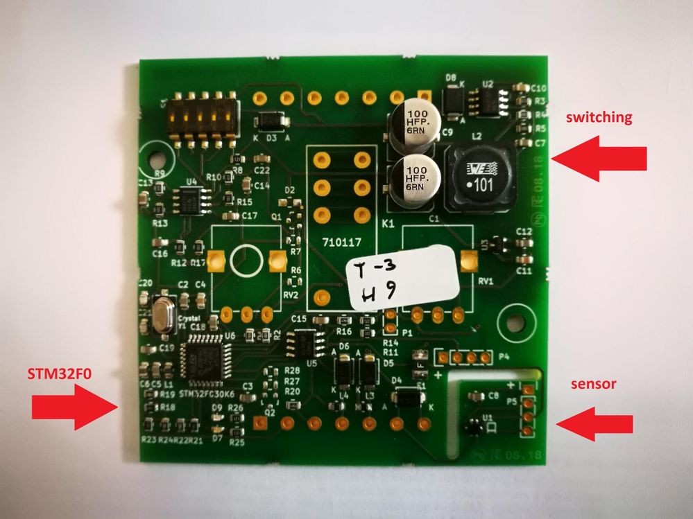

Can you, please, share the PCB layout with indications of the different components (on both sides)?
Thanks
AAssi
Associate II
This is an image of my PCB. I had follow the ST guidelines for the placement, so the source of heat are the STM32, the switching power supply and U5 transceiver. In my box, the air flow from HTS221 to the switching. The test was performed in open air.
There are nothing in the bottom sides.

​Hello.
The PCB layout seems correct.
Assuming the soldering temperature profile and re-hydration are correctly executed according to the Section 4.1/HTS221 DS as reported hereafter:
 <<The HLGA package is compliant with the ECOPACK® standard and it is qualified for soldering heat resistance according to JEDEC J-STD-020. After soldering, the accuracy specification of the sensor can be guaranteed after re-hydration of the sensor element in a stabilized environment (25 °C / 55% RH) for 3 days or at 70% RH for 12 h. Otherwise the sensor may read an offset that slowly disappears if exposed to ambient conditions.>>
the potential root cause for the wrong readings could be:
  • absorbed soldering process residuals or previous stress tests
Actions:
1.     If possible, run a microscope analysis of the HTS221 package and the sensing area to verify if they are damaged (soldering process residual over and around)
2.     Run a bake for 12h at 125 °C
3.     Run a test against the reference with the recommendation to put it as much as possible close to the sensor to verify if the sensor has recovered its performances
Thanks
