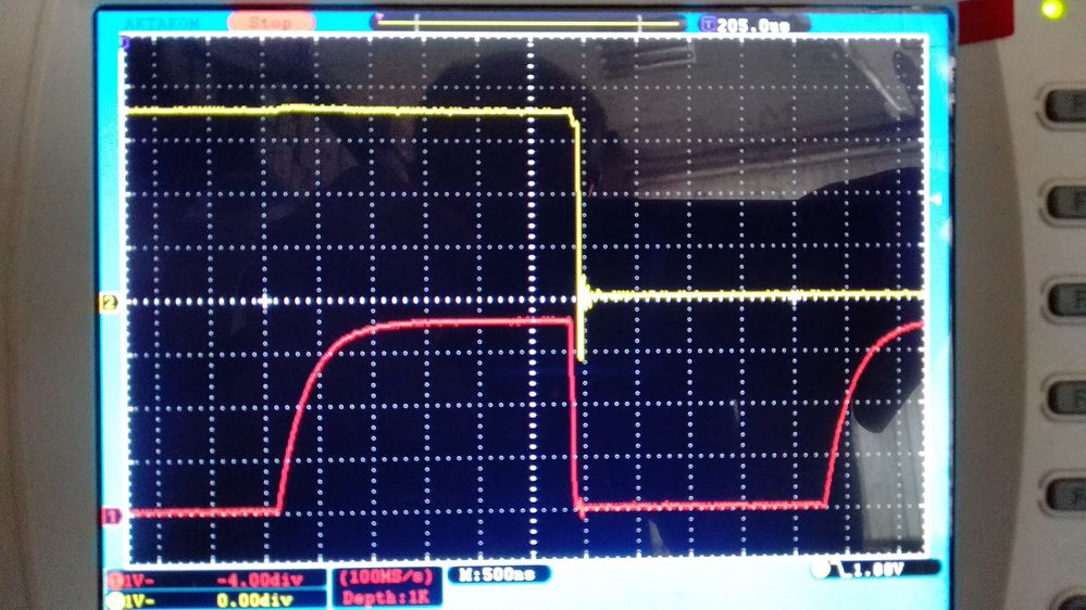

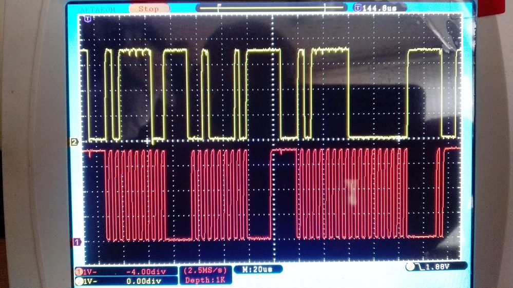

For example - reading CTRL_REG2 (SubAddress = 0x21) - image 1.
Image 2 - 500nS/dev expansion of point near +60uS on image 1.

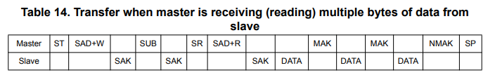

Hi Lehman, so you are building your I2C pattern in bit-banging, right? I'm checking your I2C patter for the multi-byte read case
First data byte is correctly read, while the second one is't. Are you correctly managing the MAK?
