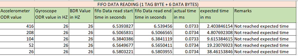

TEST 1: accelerometer configured with different ODR values and gyroscope configured with 26 HZ output data rate
 TEST 2: accelerometer and gyroscope configured with same output data rate values (ODR )

Please check attached table for more information.
Hi @srao.1​ ,
ok... but are you filling the FIFO up to a certain threshold (for example tag+3 axis values) and then reading the batch of FIFO data all together, right? If so, the speed of the reading depends on the speed of your SPI or I2C, and is uncorrelated with the ODR, because you are reading data already saved in memory. In this case, the 73ms you see are given by 1/(SPI-I2C clock frequency) * (16*3 + 8), the 7 bytes you are reading from the FIFO every time.
Could you also share the read acceleration data (+ tag) that you are reading from the FIFO?
