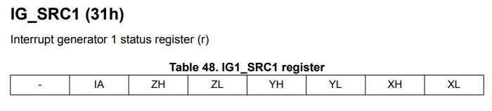

You might poll the IA bit of this general interrupt status register (see datasheet, p.39):
0693W00000NsiGrQAJ.pngYou'll clear the interrupt by reading this reg. This is a general purpose register, so you'll see here all the status of the interrupt you have set.
