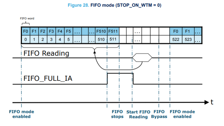

we are trying to run FIFO mode in a while loop but we observe that the FIFO buffer is not filling the second time
step 1: Configuration of Gyroscope control register and FIFO control register(6.6khz,2000dps,FIFO mode)
step 2: 100 ms delay --> 6.6Khz and 512 sample
step 3: while loop
step 4: reading x,y,z FIFO
step 5: Reading FIFO status register
step 6: 2s delay
step 7: Again Reading FIFO status register
step 8: Again it will go through step 3
can you suggest to me regarding this

Can anyone suggest some point why in high ODR 6.66 and 3.33KHz it is behaving like this? If we want to operate the sensor in high ODR what to do can anyone please reply to this

Hi @Sprem.1 ,
So you are reading higher acceleration values (from the FIFO) in the higher ODR case, right? Are you facing the same issue without passing though the FIFO?
I'm wondering if it could be effectively a measurement "issue", in the sense that in your setup there is a noise at high frequency (above the 1kHz ODR) that is detected only when you run the device at high ODRs.
You might also try to increase the SPI / I2C reading frequency: maybe the ODR is too high to be able to read the FIFO fast enough.
-Eleon
