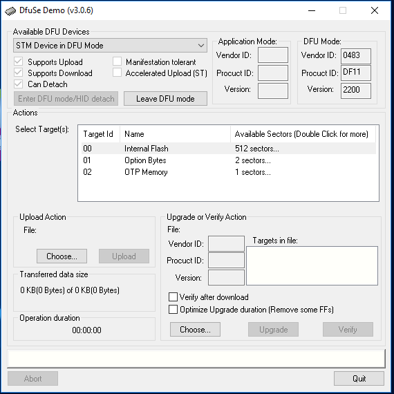

Hi @DWang​ , you should get a screen similar to this one:

DfuSe Demo didn't detect my device. "Available DFU Devices" didn't list out any device... I still suspect the hardware is somewhat broken...
