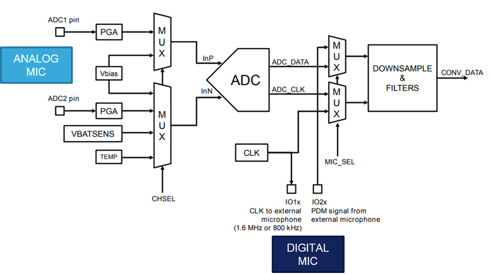

I need to connect Microphone to BlueNRG-2 and How Can I interface with the Chip.?
2019-03-15 3:58 AM
hi, it depends on the microphone you are using. If the mic is analog (differential or single ended like MP23ABS1), you have to interface it to ADC pins (ADC1 and ADC2 --> OUTP and OUTN). If the mic is digital (e.g. MP34DT05-A) you can directly connect it to PDM interface (IO1x and IO2x pins --> CLK and DATA)
Because of it's a 10bit ADC, if you are interest to a good SNR I suggest you to use a digital microphone.
Regards
2019-03-15 4:04 AM
Dear Eleon,
Thanks for the input and yes I am using digital MIC. so I can connect directly to any IOx pin which has PDM functionality as per the GPIO table right.?
2019-03-15 4:11 AM
yes, you're right. You can use IO pins in Serial2 mode that support PDM (up to 2 mics per line, if working in stereo mode). Regards
