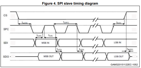

2019-10-09 8:33 AM
Hi @william.le-coz , but is your CS fixed to GND? Please note that for the SPI communication, the transition high to low of the CS pin is required.
Regards
2019-10-14 7:03 AM
Thanks, it's working now :smiling_face_with_smiling_eyes: !
I use CS with pull-up and MISO and MOSI with Pull-down.
