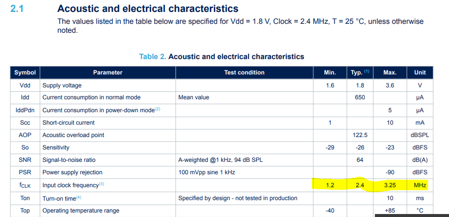

Now, this 1,024MHz is outside IMP34DT05 requirements and may explain behavior. As mentioned in previous post, this mic_clock must be higher than 1,2Mhz and below 3,25MHz
=> Here, you need to increase this clock frequency. It could explain behavior your notice.
See extract from DS :
Regards,
Sebastien.
