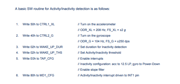

Hi @CWell.1 ,
Welcome to ST Community!
After WAKE_UP_THS you need to write E0h to TAP_CFG.
Let me know if this works!
