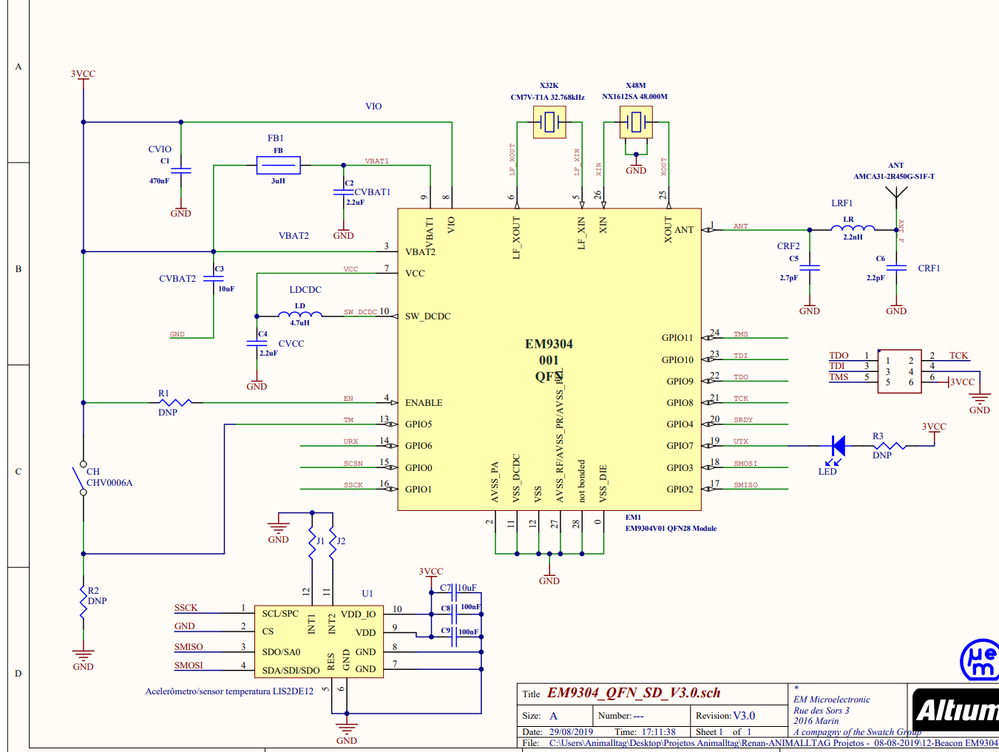

Hi, Eleon! The second 16 clock pulses are an attempt to read the same register that I tried to write data in the first 16 clock pulses. The VDD of the LIS2DE12 is tied to VDDIO. Here is the schematic for more details. Thanks!

The CS pin is connected to the ground. Is this an issue? My uC needs to control the CS pin to establish the communication?
2019-10-08 1:32 AM
Thanks @luiscarmignotto for the sharing of the schematic. Yes, you need to be able to drive the CS, e.g. connecting it to the uC, because the SPI communication starts at the CS transition from Vdd(VddIO) to GND. Regards
2019-10-08 3:16 AM
The CS signal is usually low-active, i.e. connecting it to the ground means permanently enabling the device.
You would need to check with the datasheet if CS transitions play a dynamic role in communication seqences.
