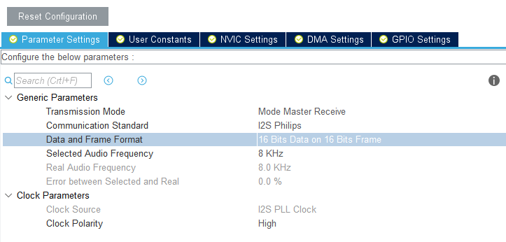

First I set up the I2S communication as below to activate the microphone.

Question 1. Is it correct to set as shown above to read the sound data of the microphone?
Question 2. Audio Frequency is 8Khz and Frame is 16Bit.

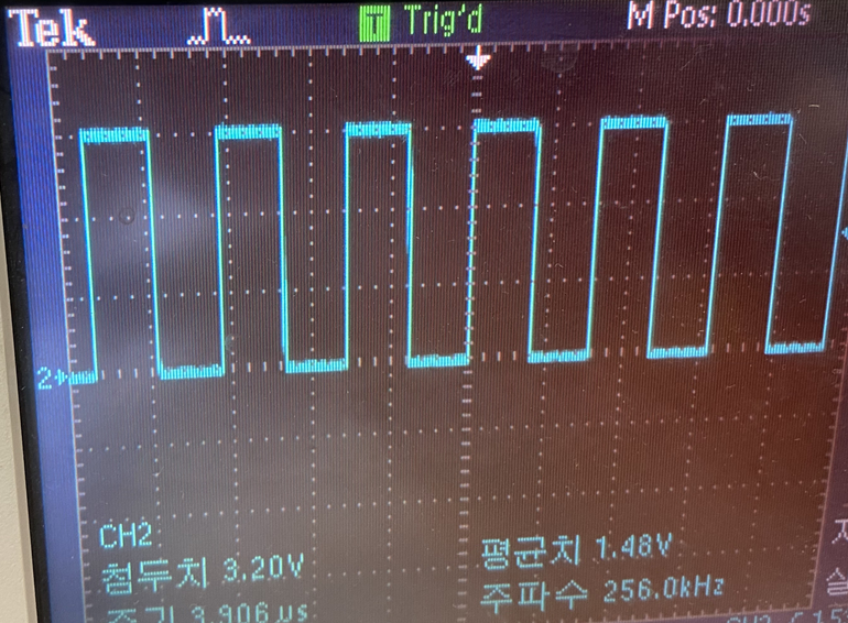

It is calculated as CLK = 8000 * 16 = 128Khz on MCU.
But when I measure my CLK with my scope, I get 256Khz.
What is the reason?

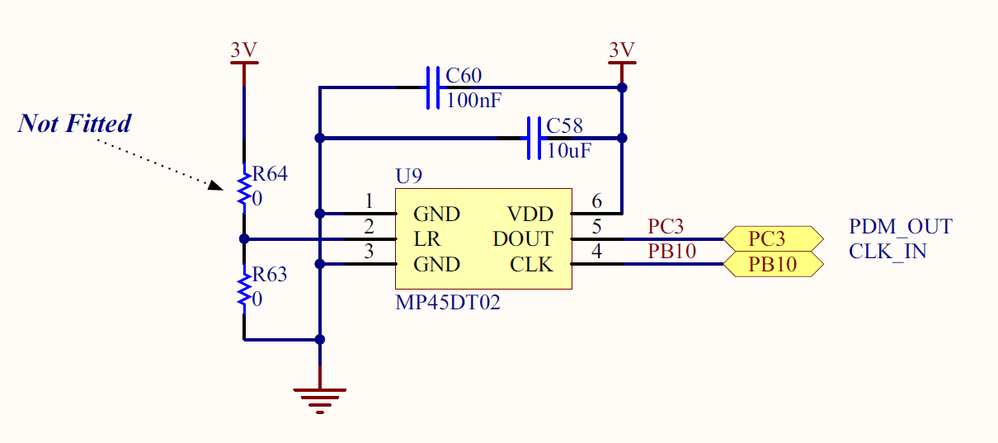

Question 3. Is there an example from ST that deals with the MP45DT02 microphone with
Discovery Board?
