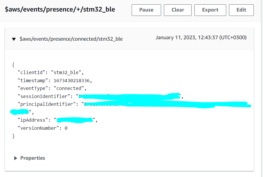

I connected to AWS IoT like this:
However, I need the AWS Subscription Topic name to be able to see my log data. How can I achieve the topic name where the log data are subscripted?
