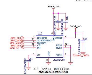

Hi, I am trying to bring LIS3MDL to power-down mode. I have set MD Bits to 2 of "ctrl_reg3" but still, current consumption is 1-1.5mA. I have attached a schematic of LIS3MDL . Any help in this regard would be appreciated.

Hi @ZHaid.1​ ,
how many LIS3MDL are you seeing behaving this way?
You might check-first the current consumption just after the device power on (MD Bits are '11' by default).
You should also check the default configuration of the SPI pins and the INT and DRDY from application processor side: for example, the INT and DRDY default states are low, check also the SPI ones (e.g. the CS) and tray to change them, if possible, to check if you have an extra-consumption coming from these lines.
-Eleon
It is occurring on all our boards
I will get back on this thing.

For example, the INT and DRDY default states are low, check also the SPI ones (e.g. the CS)
Pin Status when device starts:
Status of BSP_LIS3MDL_INT_PIN = 0
Status of BSP_LIS3MDL_DR_PIN = 0
Status of BSP_LIS3MDL_CS_PIN = 1
Pin status in continuous mode:
Status of BSP_LIS3MDL_DR_PIN = 1
Pin status in power down mode:
