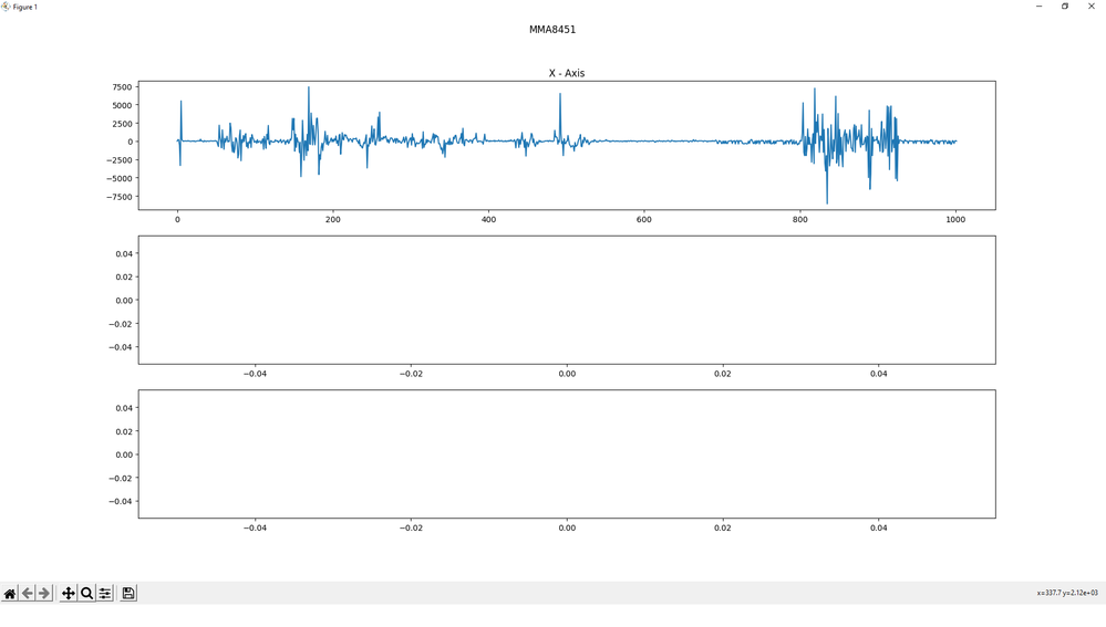

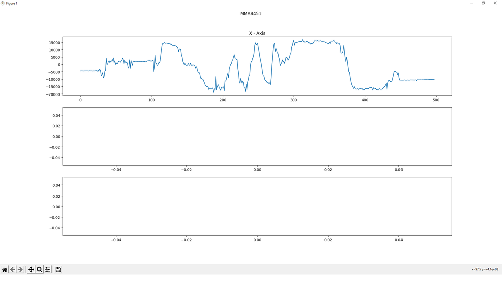

Desired behavior is shown on the first attachment (mma8451_sensor). When I read and parse LIS3DH data it seems that data are fluctuating(lis3dh_sensor) and cannot remain stable. Could you help me what am I doing wrong ?

Hello, thanks for the response. Casting the MSB to int16_t has partially solved the problem.
There is a difference in behavior between mma8451 and lis3dh. As You can see on the plots, the lis3dh returns to the '0' value when there is no movement, but the mma8451 chip 'remains' in the current position. Is there any possibility to provoke lis3dh sensor to get current position, not only the 'movement' related value ?
Please take a look on below pictures that will explain what I mean:

Hi Jakub,
probably in the mma8451 there is an embedded (default) high pass filter, that removes (also) the Earth acceleration (so your steady reading along Z is not 1g but 0g).
You can enable this filter also on the LIS3DH, by configuring the HPM1 and HPM0 bits of the CTRL_REG2 (21h) register (datasheet p.36).
https://www.st.com/resource/en/datasheet/lis3dh.pdf
It is explained in more detail in the application note, p.17.
