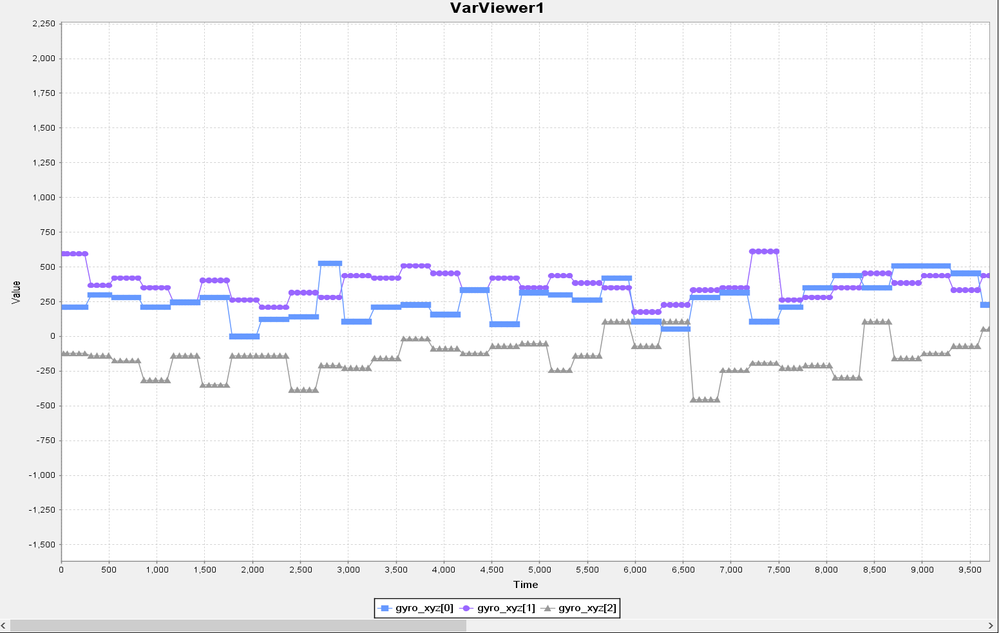

PS: below is the curve of gyro data.0693W00000LvnjYQAR.png

Ok, I figure out myself.
GyroX = raw sensor data * sensitivity (mdps/LSB or mdps/digit), here the unit of GyroX is mdps, so the result above looks reasonable. Though, the gyro data still has some drifts sometimes.
