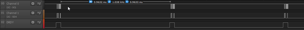

The communication should look like this:
I suppose you are reading the data too slowly, so new data are available earlier than you read all registers or you are not reading all output registers so the DRDY is not cleared. Please check you communication with scope or logic analyzer and eventually share it with me.
You can also try to reduce the the ODR.
