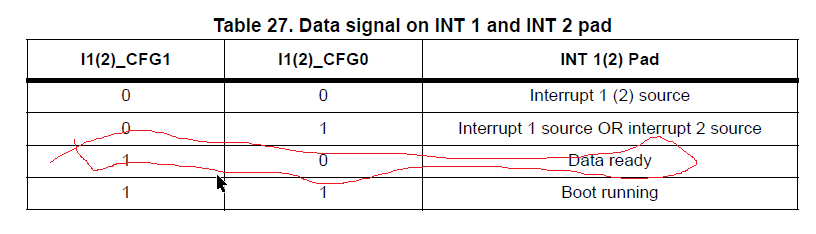

CTRL_REG3 configured as 0x02 to data ready interrupt on INT1 pad
I tested with 0x00. Then data  ready interrupt is not generated.
Do we need to configure the register 30, 32 and 33 for data ready interrupt on INT_1 Pad?
