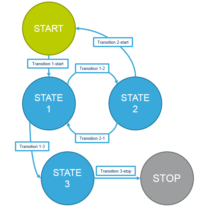

From theory, we define a Finite State Machine (FSM) as an abstract machine that can be in exactly one of a finite number of states at any given time, and is composed of a START state, a STOP state and a series of states, conditions and transitions. But how is this definition practically implemented in LSM6DSO sensor?
For the LSM6DSO sensor, FSM is intended to detect a specific gesture: there are up to 16 independent state machines, both XL and G (and external MAG sensor) data can be used, and a number of interrupts and source registers for the event detection management are available.
