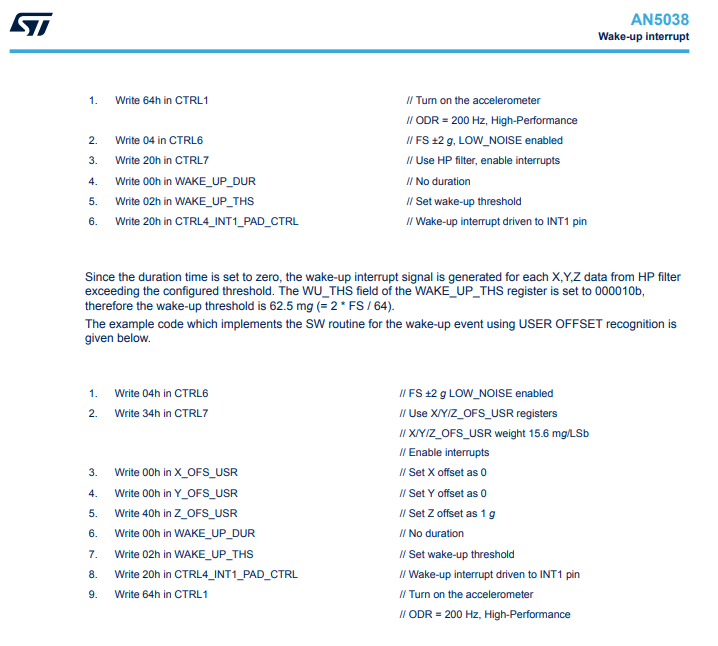

I believe you could achieve your goal by using the wake-up embedded digital feature. A wake-up interrupt generated while the device is running always in normal mode. This feature is described in application note AN5038 p.21.

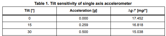

You can define a threshold calculating the component of the "g" acceleration on one of the 3 spatial direction (see the AN4509 for a detailed calculation of this value, you can find some examples on page 6) and select the axis on which you want to detect the interrupt event.

I went through the document and tried something. I am getting interrupts every time even in stationary(When I set feed and random offset value for all three axis, without that what I am getting is TAP interrupt only). Turning off interrupt for an axis also I haven't seen, other than for Tap(which is very much required).
Can you give more light on weight setting , offset setting for each axis. Is that offset unit is 'mg' or it is angle, the maximum value of THS is 6 bits, so how it will be related to a large angle value.
I have seen a conversion fs2tomg (multiplying with .016, may i know how arrived in this calculation), is there a calculation for raw to angle in the same way.
All I expect is if I gives an offset 10, if any of the axis is tilted to more than 10degree from its current baseline, it should generate an interrupt.

the AN4509 reports some of the thresholds related to the tilt degrees. Suppose you have your device with the z axis measuring 1g (flat position), the x and y axis will measure 0 LSB = 0 mg. If you set the threshold at 15° and enable X_WU and Y_WU (not the Z_WU), because the Z_WU would always generate an input when in flat position (Z = 1 g).
For setting wakeup for tilt angles is not worked , I referred
https://www.st.com/resource/en/application_note/dm00401877-lis2dw12-alwayson-3d-accelerometer-stmicroelectronics.pdf. page no.22.
But What I have seen is the interrupt is generated for TAP events not tilt. The code I pasted below
Is it possible to enable/disable an axis from interrupt for wake up?. I have seen options enable/disable axis for tap interrupt only. Rather I think we might need to set offset only for the required axes, please correct me.

If the wake-up threshold interrupt can work for offset values set in x,y,z, that is what exactly I required(but not with TAP interrupt, as in my case device may get very slow tilt). Do you know Why I it is not getting interrupt for threshold and offset setting as I described in the post above
