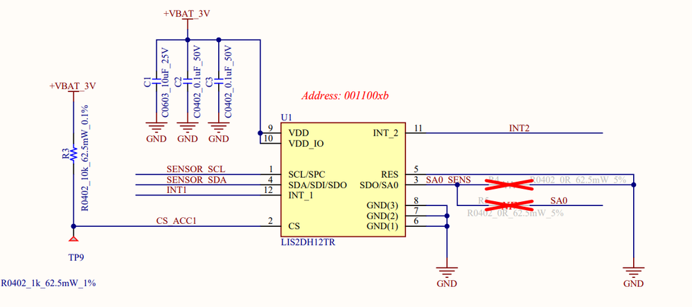

2021-11-16 4:25 AM
Hi Eleon,
Thanks for your response, I did the same steps and still not caught any free fall interrupt. plz find my hw portion. Is there any issue with my design to get the interrupt.
But I am getting the xyz axis data and not free fall alert.
Regards,
Ani
2021-11-16 6:55 AM
Hi Ani @Akuma.6 ,
the schematics looks correct, the SDA and SCL lines should be connected to the Vdd IO via pull-up resistors, but you might have done in another section of the schematic. Just one question: is the SA0 pint floating?
Did you check from the raw data if you are actually crossing the free fall threshold limit? Can you share the raw data here?
You might also try to configure the interrupt, latching it (i.e. acting on the LIR_INT1 bit of the CTRL_REG5 (24h) register), or reducing the interrupt duration from 03h to 01h or 00h.
-Eleon
2021-11-16 8:24 AM
Hi Eleon,
Thanks for your observations.
Pull-up is ok from our MCU end. Yes SA0 pin is floating not connected this line anywhere.
I am getting the XYZ raw data and seen the static to movement and movement to static.
But using with this XYZ RAW data can we implement the free fall? and i will provide the register value and raw data in next mail.
CTRL_REG5 (24h) register configured with 0x08 value and I tired interrupt duration 00, 01, 02, 03 and 2g/4g tested but no luck.
