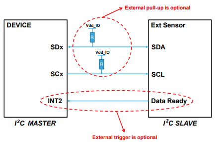

Also, could I please get a more clear example/schematic of how to hook these two chips up in this mode? I was planning to connect SDA (pin 11) and SCL (pin 1) from LIS3MDL to MSDA (pin 2) and MSCL (pin 3) on LSM6SDS0X. Is this correct? What should I do with MDRDY on LSM6SDS0X? What should I do with DRDY on LIS3MDL? Should these pins be connected to each other?
Presumably I should use pull-up resistors on the master I2C?

Regarding your other request "could I please get a more clear example/schematic of how to hook these two chips up in this mode?", you can find the description in the AN5272 app note, p. 65. External pull-ups are optional, but I would suggest you to add them to your circuit.
