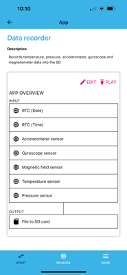

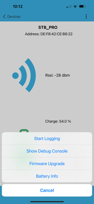

i am actually trying to load on my an sd card my data of the sensor tile.box. Unfortunately, I only get blank tables with only the top written. I uploaded a configuration to make it and then uploaded as seen on those photos. am I missing anything?

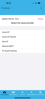

i have also a question on those parts of the application, I do not know what they are made for and they are only in this program:

You are using the old version of the app ‘st ble sensor classic’, you must use the new app ‘st ble sensor’.
In the new app the flow ‘data recorder’ in the flow samples works and correctly generates the file in the sd card.
For the cloud functions, the app handles the MQTT protocol, but for the server you have to provide it yourself.
