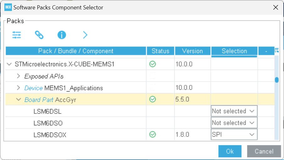

Added in Software Packs Component Selector an LSM6DSOX - SPI (v1.8.0):

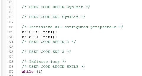

in your code i see no hspi init:
so : define spi in Cube -> generate code ! and compile again...hspi should be there then.

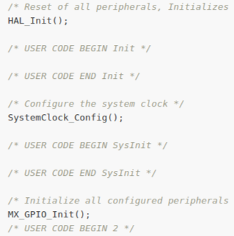

did the steps again with a special care of:
- Cube -> Project -> Generate Code. (this switches view to main.c)
- Cube -> Project -> Build All.
Nothing new appears in section you showed.

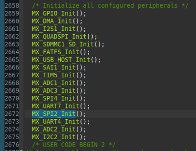

btw no need for "build all" ; just use the nice symbols : the gearwheel to gen.code, the hammer to compile. :)

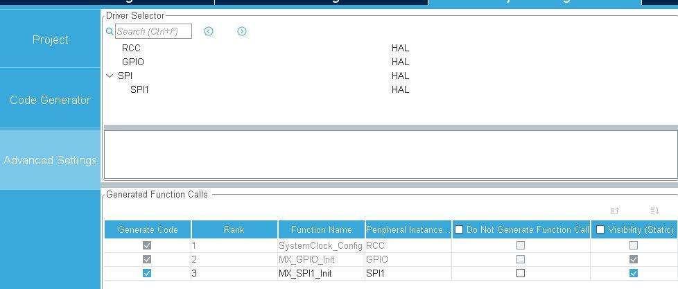

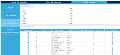

see - all used units get a call for init:
except you dont want it -- see in project manger -> advanced settings:
when you activate/use the spi - is the mx..init active and also no "do not ge. function call" set ?

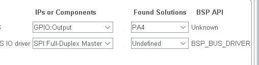

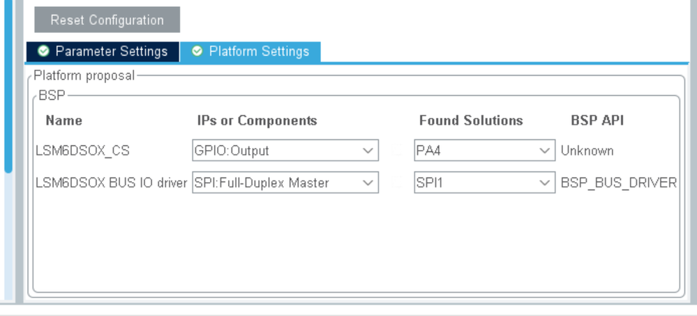

If I leave undefined BSP_BUS_DRIVER
then SPI is visible in Advanced Settings:

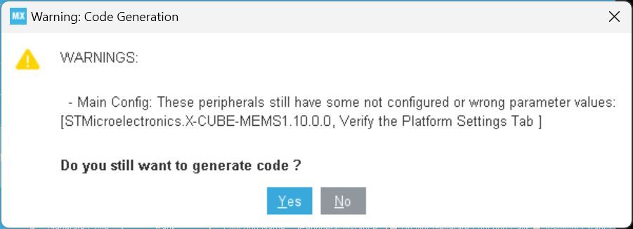

When gearwheel is pressed a Warning appears.
If Yes is pressed, code is generated:
I think I'll live with it :)
