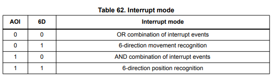

Hi @DDavi.3​ , yes you can, and you can choose if the two interrupt that are combined on the same INT pin are in logic OR or in logic AND. If for example you want to raise the interrupt when a the physical event exceeds Threshold1 AND/OR Threshold2, you have to configure the two thresholds, route the two interrupts 1 and 2 on the same pin (enable I2_INT1 and I2_INT1 of CTRL_REG6 (25h) register), and enable the AOI/6D bit of the INT2_CFG (34h) according to the table below. Regards
