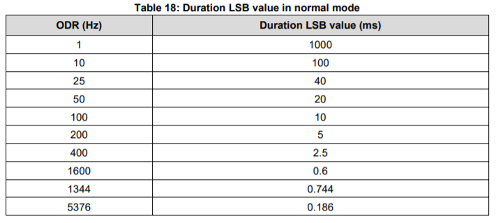

More specifically, you can refer to the App note AN5005, p.22:
The content of the duration registers sets the minimum duration of the interrupt event to be recognized. Duration steps and maximum values depend on the ODR chosen. Duration time is measured in N/ODR, where N is the content of the duration register.
