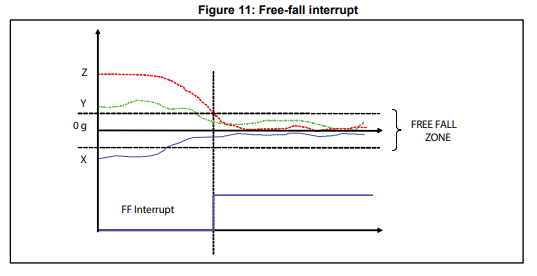

2022-08-17 3:34 AM
Hi Swati Upendra, @SUpen.1 ,
you can also detect the free fall (strictly speaking), i.e. the event during which the device is falling (the 3 axis acceleration approximates to 0). See app note, p.26.-Eleon
